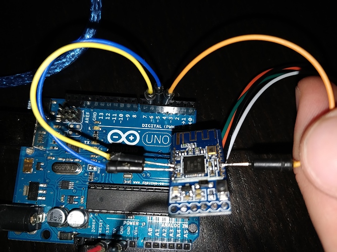

Try to send AT+HELP\r\n
to see the list of commands, then AT+BAUD
to check what baud rate it has. Or try changing VESC baud rate to 9600 and test with @emmaanuel app?
@davidbonde If your both VESCs have ID 0, then it doesn’t matter which one you connect the module to, that’s why I recommend that. Leave CAN Fwd disabled and Multiply enabled
AT+BAUD is already good (115200). What about mode (peripheral, central…) ? And parity ?

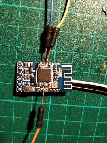

I didn’t make any progress on it ATM. Need to rewire it to an arduino and throw few AT commands to check UART comm.
Keep in mind that upgrading the module firmware is a tricky stuff though.
