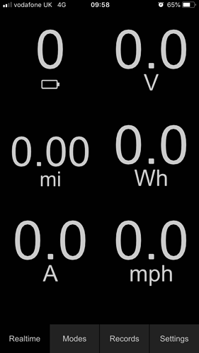

It is looks SO freaking nice with metr in dark mode!
