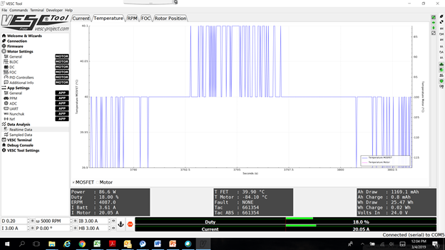

I Motor = 20A
I Motor = 30A
I Motor = 43A
Completed some initial tests at 24V to 27V. The temperature to look at is T FET. The current to look at is I Motor (Phase amps). This is the current that the MOSFETs pass to the motor and therefore cause the heating. The motor was ran at 18% duty cycle in BLDC control mode. Each current limit was tested for at least 3 minutes or until the MOSFET temperature stabilized.The conditions weren’t ideal with the controller sitting in still-air with only a relatively small amount of aluminum for heat sinking. Real life conditions will most likely be much better when the controller is in a full aluminum enclosure with wind rushing past it as you ride down the road/sidewalk. Overall this gives me confidence that this controller can handle 40A to 50A continuous for a decent duration when placed in the mentioned ideal conditions.
Understand that I am testing continuous current limits. This means that you can still deliver higher phase currents to your motor for a short duration such as for accelerating.
I will do loaded tests at higher voltage levels later this week to see if this can handled the coveted 12s battery.
*Test conducted in 23C ambient temperature. Hotter ambient temps will decrease max continuous current handling capability
