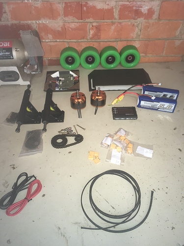

So this is my second build and parts are starting to arrive, I thought I’d do a build thread to try and help others looking for an affordable diy option.
So far I have gotten the esc and 97mm clones. Both of these parts I ordered form @dickyho and have arrived form China within 2 weeks. Now that is just amazing service, the parts were also very well packaged and I am very happy with the quality and price. Thanks Dicky

This took longer than I thought but I think all parts have arrived now so I will be starting to do a mock up later tonigh and will have more pictures then
