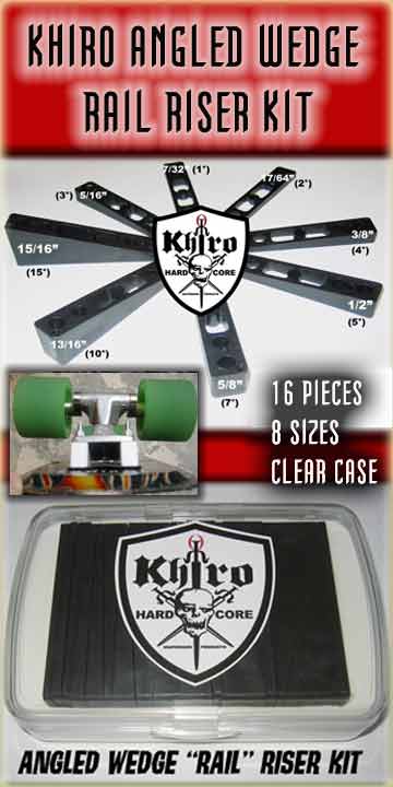

A kit like this will help you out greatly…
Awesome i like those wedges @Deckoz and imma look at the kit @squishy654 …so im guessing this has been done. Anyone got a pick of a bild like this?
