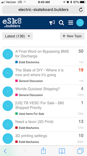

Edit: dang I love it when I fill the whole front page with my name
