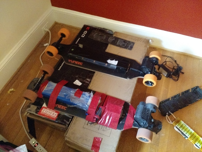

Boards - Stock + Modded (VESC + Wattmeter + 10s4p custom)

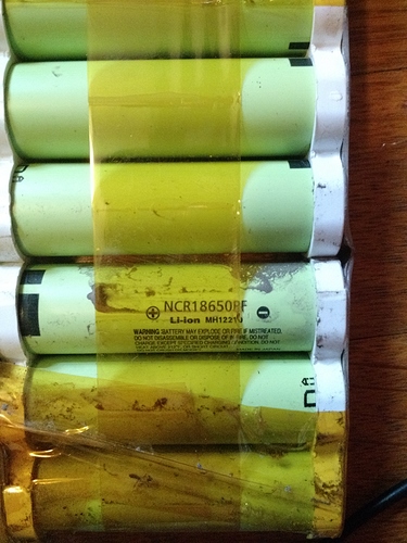

Yuneec Battery Cells - NCR18650PF, 2Amp Cont.Disch

The cells are rated 10Amp max discharge. So 3 parallel cells should be able to provide 30 amps. Here are some specs I found on these cells : http://www.rc-electronic.com/downloads/pdf/infos/datasheet_LiIo_Panasonic.pdf
Whoops. I gave the amps for the VTC4s I just ordered.

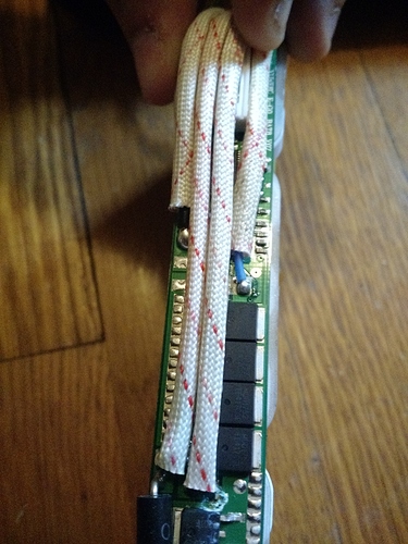

I recently purchased two yuneec e-go from ebay. One was in perfect working order and the other one had “connectivity issues” according to the ebay listing. Well I finally had a chance to open up the defective e-go to see what was the issue.
The connectivity issue was actually a defective battery. The board didn’t turn on. The remote control that came with the board worked perfectly with my first board.

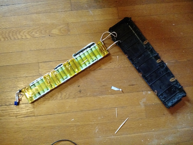

I opened up the battery and here is what I found. The BMS had some of the FETs (or diodes?) melted of from the solder from their base. They had also melted off the blue plastic shrink wrap that held the battery together. I soldered the FETs back on but that did not fix the battery. Next I tried to charge the battery but it had no effect.
I checked the battery voltage and it was 6.2 volts on the blue EC3 connector. This is waaaaay too low for a 7S lipo, it comes out at less than 1V per cell. This means that the cells themselves are completely discharged and, I’m afraid, beyond salvageable (I think?).
I also checked the fuse in the battery. Its a 30Amp fuse. The fuse was in good condition and had continuity as confirmed by the cell voltages. The 30 Amps was as high as Yuneec designed the battery to output and I can assume the ESC should be capable up to 30 Amps.
I checked the ESC and motor by unplugging the battery from the working unit and they work perfectly.
Therefore, I’m left with a Yuneec E-GO that only had a bad battery/BMS.

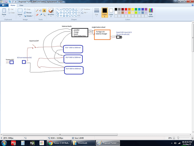

I’m thinking of getting three (3) lipos with 3000mah to 5000 mah and a cheap lipo balancer to function as my bms. That way I can build a lightweight 9S1P battery and be over the original 7S but below the 10S people say burns the ESC. Hobby king sells a balancer board where you can plug in up to 6 batteries and they will all charge while balanced. I plan on getting a super cheap balance charger from turnigy for battery management.
I’m planning on using the original switch and the VDC input jack to power the lipo balancer to charge the battery. I’d need a new 12 VDC wall adapter as the cheap turnigy balancer will not take the 29 volts coming from the original yuneec wall adapter.
Also, the drive wheel is overmolded onto the gear itself so there is no way of removing it. The wheels themselves are not particularly heavy or bad. I may end up keeping them.
I may change the bearings for biltins.
The deck is actually flexible once the battery is removed. It is also not particularly heavy. I think I can reuse it, but I would attach the batteries and cover in a way that does not hinder the flex. Otherwise I may get a Never Summer Heist board which is super flexible and really light.
Any ideas suggestions are welcome.

Did you notice how the Yuneec BMS has an open balance port on the BMS? I’m building a BMS based on their slim, pretty board using the higher voltage version of the Texas Instruments; BQ77908A Multi-Cell Lithium-Ion/Polymer Precision Protector (http://www.ti.com/lit/ds/slusav5a/slusav5a.pdf). To be honest, 7-8s is the safe range to keep using your Yuneec hardware.
To reuse the battery pack case (power switch and jack), you should make sure to really fill in the area around the switches/ports with hot glue or waterproof kitchen caulk (to prevent water damage). The switch CANNOT BE USED DIRECTLY TO CONTROL POWERFLOW. To use it, you connect it to an antispark switch/circuit that acts as a relay (otherwise your switch will be a instant flash fire hazard). You can disassemble a LiPo pack and fit it into the Yunneec’s cabin, but you’ll have to make sure its safe from puncture and water and that all of the parts fit.
In your position, I would suggest you ask someone to vacuum form you a box for just the batteries and antispark switch and run battery wires over/under the board. I have one working yunnec battery, a battery shell, and a 10S I’m using with my fully modded Yuneec. If you end up deciding you don’t want the Yuneec battery shell, I’d be happy to take it off your hands - they’re flexy enough to fit some firmer boards.

While you have the yuneecs as they are, put ducttape under the ESC and cover up points where water can leak in (Bottom, LED side, and switch side). Yuneec should not be able to say that you can ride through puddles/rain.
