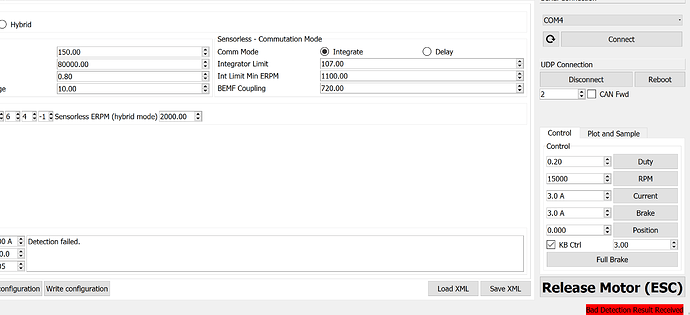

Just uploaded the VESC enertion 6355 firmware on the “bad” VESC… Every time I try reading the configuration from the motor, I get a bad detection code:
And the other one can be read without problems:

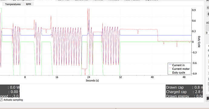

That being said, here is the current/duty graph which makes me convince it’s a bad motor/bad motor connection:
Switch the motors, if the problem follows the suspect motor, it’s the motor. Otherwise it’s the vesc.
Go back to bldc mode. Manually Copy the settings from the good vesc to the suspect vesc and see if it still runs in bldc.
