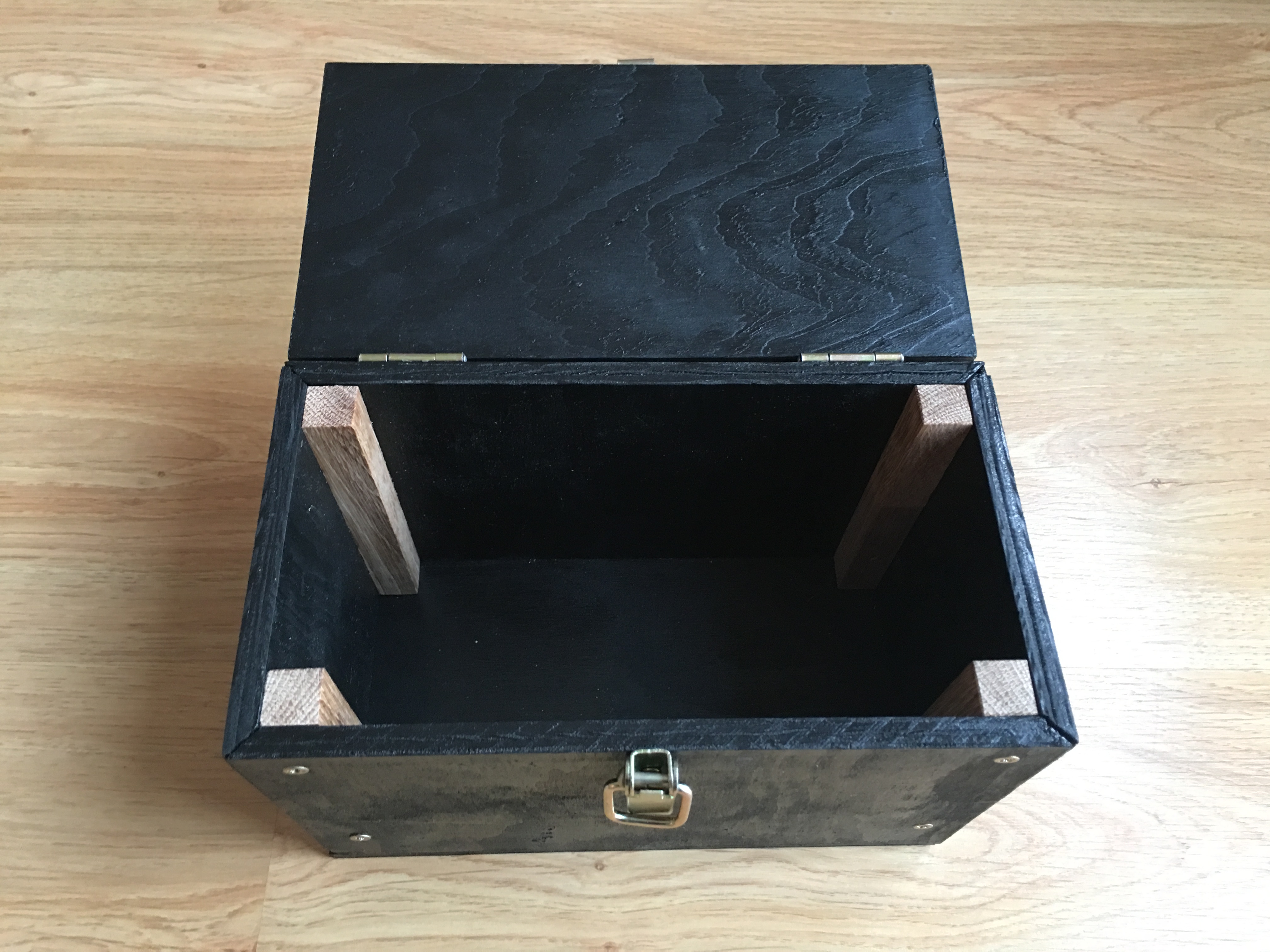

It’s actually a perfect size. It’s 100x200x75 mm. The ZIPOs I’m getting are 24x167x69mm, so that’s 96x167x69 mm for four stacked along the shortest side = perfect match. Unfortunately, there’s no space left for a VESC.

Made a battery box! It’s probably a 30 minutes project for most people with the skills. Well, I’m an IT guy. I have never really built anything. I have helped my kids with lego a few times, but that’s about it. So, it took me about a week. It’s as bad as it can be. There are no two pieces that align well. The paint is uneven. There are some extra holes where I drilled at wrong places. And I think I made it higher than necessary. But, it’s a battery box!
Hey everyone starts somewhere with DIY
Maybe you could add some foam to the sides of the box to dampen any vibrations the lipos might be subjected to?
Don’t worry, you can redo it later if you want. As @Der6FingerJo mentioned I would add neoprene or foam to secure the batteries. Also add a gasket between the 2 parts of the box otherwise it will rattle and debris and moisture can enter. And maybe you find some edge protectors because it could really hurt if your leg touches an edge when falling.
Thanks for the tips guys. The batteries are a pretty tight fit, but I’ll try to squeeze in a little bit of foam.
A gasket sounds like a very good idea.
I also found these very safe looking edge protectors: https://goo.gl/images/SkwHTd
BTW, the box is meant for both batteries and VESC. The VESC will go under the batteries. On the last picture, there’s about 2.5 cm of space under the batteries. The space at the sides is for battery-VESC cables. The batteries won’t sit directly on the VESC. There will be some space between them. I hope that helps to reduce heat, though I’m not really sure it will make a difference.
I suggest doing it the other way around, Vescs on top. It´s better to access and you don´t have to worry about batteries damaging them over time from vibrations. Also like you mentioned better heat dissipation. If you want your wires to exit at the bottom, simply route them down at the sides.
