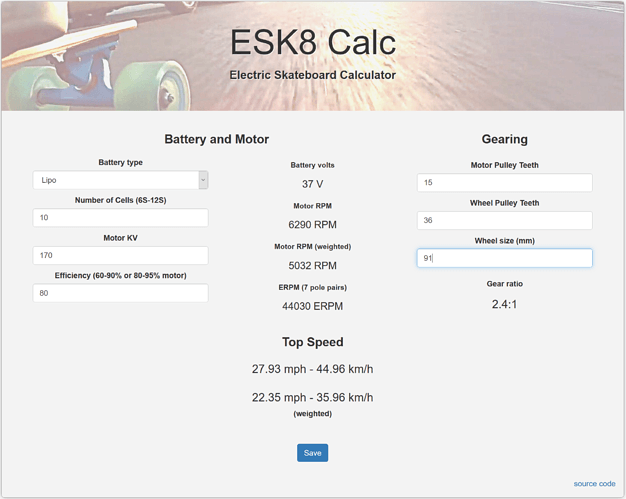

What I did was calculate the speed at low voltage by going 10 series to make the voltage 37v as you can see below. Top speed weighted is 35.96km/h. Lets round it at 36km/h

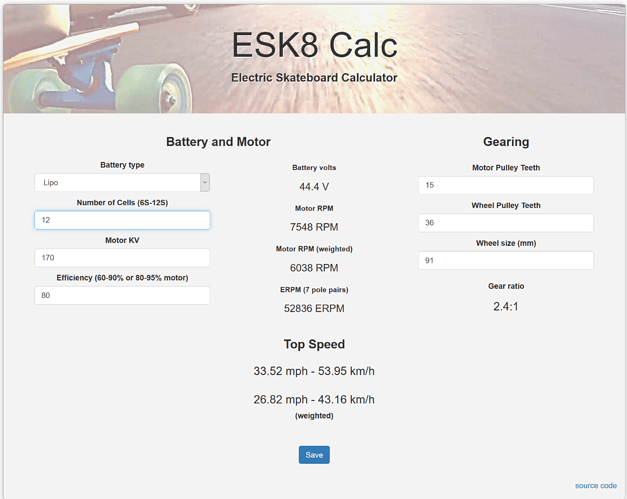

Now when the battery is fully charged in the esk8 calculator by going 12 series to get 44.4v, I get top speed weighted at 43.16km/h, lets round it to 43km/h
What I assumed to do is at max wattage on low voltage of 37 would be 37 times 40amps = 1480 watts for 36km/h
Fully charged at 44.4v would be 44.4 times 40amps = 1776 watts at 43km/h.
