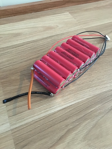

Are those Sanyo batteries? I think those are 10amp cells. If so then ur sucking them way beyond what they’re designed for if 2p. Even 4p isn’t advised.
No they are not Sanyo cells. They are LG HE2 20A cells. Now when using those two 5s3p batteries there is no more voltage sag. I have limited battery max to 30A so I am only pulling 10A per cell. I also made a new enclosure for them:
