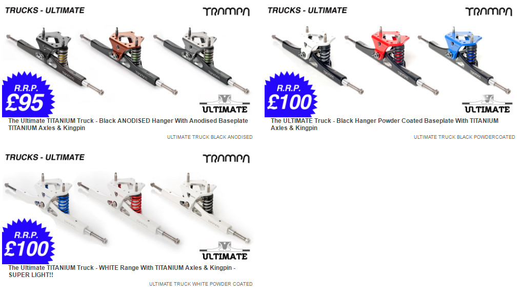

@trampa Would you consider producing the ultimate in black or raw finish? These are the hangers I want but don’t really want white.
why dont go with the black ones if you dont like white ? http://www.trampaboards.com/the-ultimate-titanium-truck--black-anodised-hanger-with-anodised-baseplate-titanium-axles--kingpin-p-12298.html
Cheers
@trampa are the últimates 16" hangers?
Do you have a picture of these trucks on an Street Carver Board with street wheels?, I’d love to see that.
Its clearly described that these are 16" Hangers, reading helps (-;

There are ultimate (16") and ultimate carve/mini (12.5").
If I’m doing an urban carver, I want to stay 12.5"
Frank: Would the Ultimate Trucks (complete) fit the Street Carver deck?
Or I’d need to buy the Mini Vertigo Baseplate and the Ultimate hanger separately?
Baseplate Mini Vertigo
Ultimate truck hangers:
The ultimate truck has no inner spring position. So you would need to have the street carve Baseplate. Tell me what you want and I tell you the best way forward. We can build anything.
