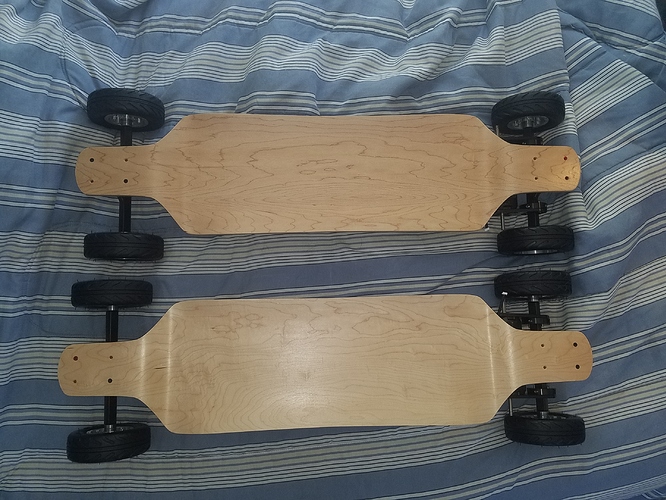

Letting buddies ride my boards is a slippery slope…been asked to build 2 boards…decided to do them as twins - the same but with some cosmetic differences.
All parts either here or coming:

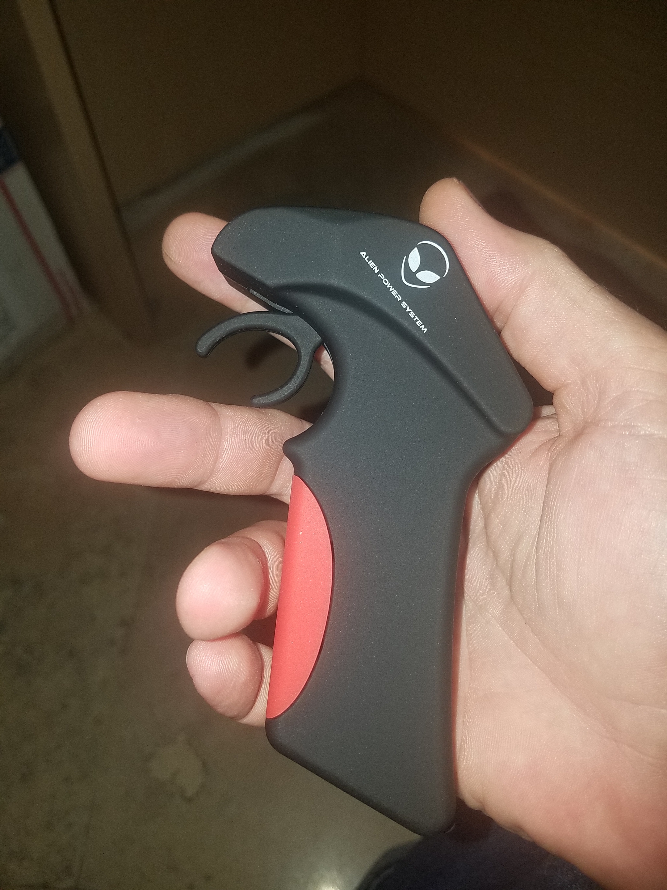

2 Alienpower controllers
The wheel pulley in the pic is @Titoxd10001 15mm…plenty of room to adjust with moving clamps and using spacers on axles…in the pic I just put 2 wheel bearings on each axle to space out…lots of flexibilty…
These will be running @psychotiller 6 shooters when they get here with 12mm belts…
Unfortunately the chat attendant on @torqueboards website told me the regular clamps would work. Now I’m having to wait for a response from Dexter about getting clamps.
There’s a little ridge on flat side of the TB hanger. it makes it not flat. Thats the only reason your clamp doesnt work. It would be really easy to flatten out that ridge with a dremel or file.
