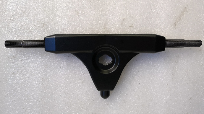

and these parts go with this hanger. nut is reverse threaded. hub is threaded. so effectively a big nut with a locking reverse threaded nut on top.

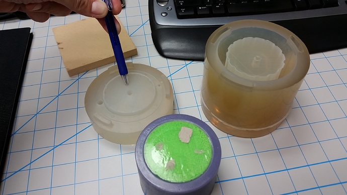

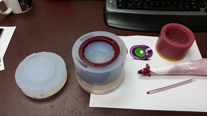

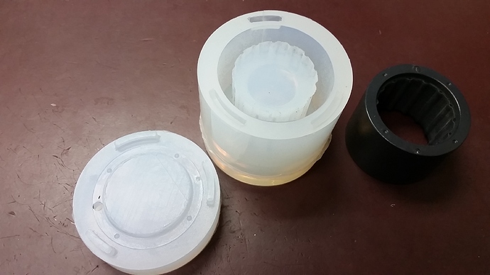

Back in the Hummie V1 motor days, I made the first round of hand poured wheels for testing. I did some translucent green wheels that looked really cool. My mold was also set up much nicer than the production wheels with the mold split line ending on an edge rather than mid-span on the wheel so I never dealt with flashing. I’m still running the same urethane and ride about 5-10 miles a week running my dogs for exercise. From what I know of running production wheels with cool graphics and all that, you need to supply many dozens of molds to the casting facility at a big expense. It’s cool to see the evolution of Hummie’s motors so I here’s to a productive 2018!

Nice, how did you made that mold? acrilics lids and body plus a 3d printed insert?

Thanks, did you tried using the 3D printed pieces directly? if sanded and primed you can get it very smooth
I don’t want to hijack Hummie’s thread too much talking about mold making but the original pattern was a 3D Printed piece made on an Objet Polyjet printer which has much better finish quality than a typical FDM style most consumers use for making parts. The print was sanded, primed, sanded again, and then molded in a high durometer silicone for dimensional stability. I work in the silicone and urethane casting material business (technical sales, teaching, and make all of our tutorial videos) so I ended up helping on the project when I knew I could prevent mistakes. Wheels were the EZ part. Motors, bearings and windings was where Hummie needed to spend his energy fine tuning.
