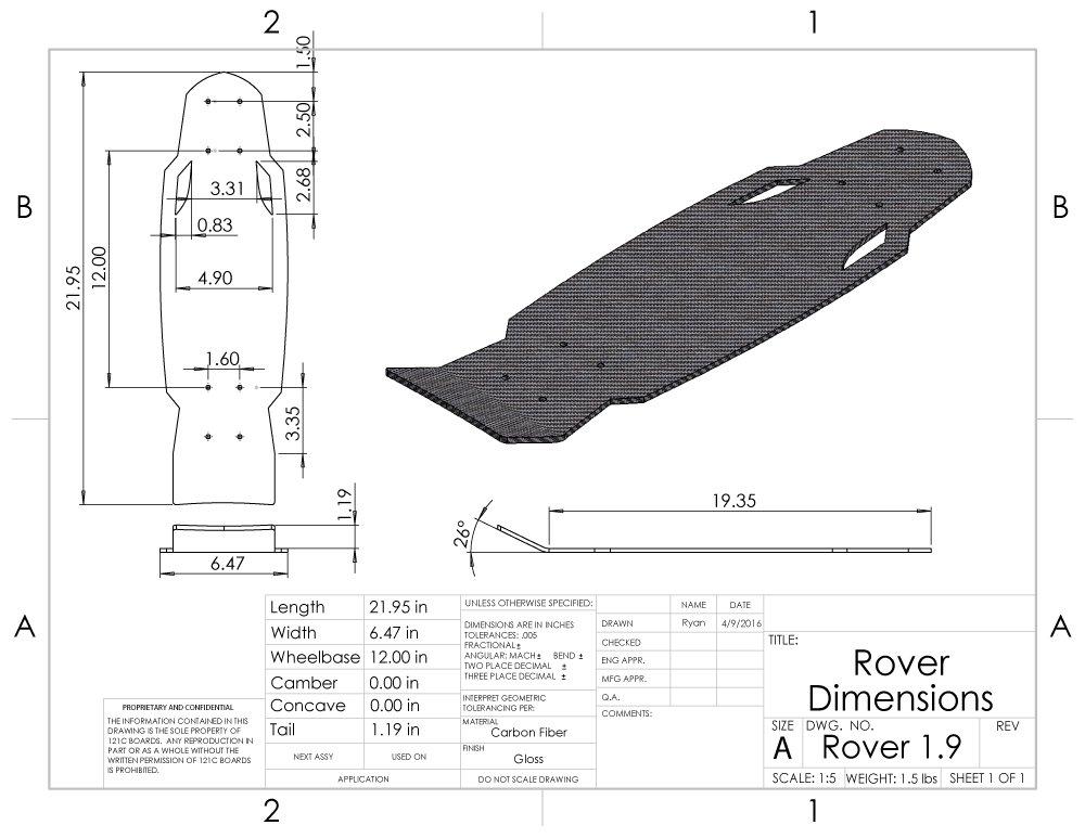

My aim is to build a pocket transporter, something I can clip on my backpack and easily make it around campus. I have a 121C Rover Deck @ (1.5 lbs), 125mm Randal Trucks, and Shark Wheels. Here’s a picture of what it’d look like fully assembled:
Here are the dimensions:
Requirements
Swappable Battery (range without weight)
FOC-enabled (low noise)
15% grade for 200lbs+
Current Design/Implementation
Hummie Steel Hub Motors (I need low-profile hubs so that I can put them on very small 125mm trucks. These seemed like the best I could buy).
No shark wheels (because hubs)
12s1p battery from Carvon (To prevent voltage sag, I hear the A123 26650 is the way to go).
Looking into RoPD connectors for the swappable batteries.
2x Torqueboard VESCs.
GT2B remote
2x 121c Decks (The current 1.5lb board, unfortunately, has waay to much flex to be safe. I’m going to try to sandwich two of these decks together to add strength, then to see where I’m at. Potentially, I could cut some of the carbon fiber to implement some nifty enclosure options, we’ll see).

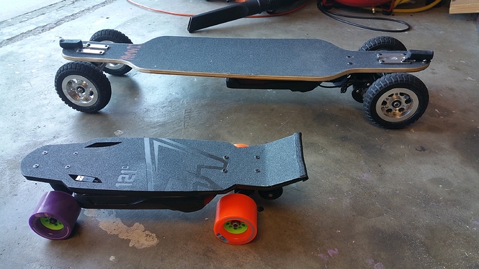

Soooo what is that battery and mount? I’m looking to build a mini like yours with a swappable battery but with an all terrain mech setup. @faust
Great fuckin job by the way this little thing is dope.
Everything else from the X2 was gutted and removed (e.g., trucks, hubs, ESC, etc…). The battery had to be rebuilt from scratch because it was not powerful enough (default from Onan is 10S2P 20A discharge @ 4400mah, new battery is 10S3P 60A discharge @ 9000mAh). Hangers were from randall 125mm’s, I forget who made the baseplate for the front truck (I needed to use a different one to match height).
Unfortunately, I was never able to get the Hubs to work smoothly. This is meant to be an “urban navigator” sort of board. It was built with street faires or crowded college campuses in mind, enabling you to easily stop and go at very slow speeds. I could never get the hubs to start and stop smoothly.
9000mAh swappable battery. This makes it the longest range for any swappable battery system (30x Samsung 30Qs). For comparison, this little battery is 9/10 the capacity of the Evolve GT at about 1/3 the size.
125mm Randall Trucks. This is the smallest wheelbase + trucks that I’ve seen on any esk8, making it extremely maneuverable in tight urban spaces.
Integrated usb connectivity (made available on left slot)
Integrated battery meter visible while riding (opposite the USB connection, not shown in image)
Integrated Shredlights (powered using the esk8 battery, so you never have to worry about charging them).
Bluetooth connectivity, ollinboards 170kv motor, FOCBox, Onan enclosure.
Shortly after my board was stolen, I got injured, so I haven’t been able to ride for months. Sad because the board was in complete condition – the best esk8 I’ve ever owned. It was super smooth and maneuverable at like 1 mile an hour! I could walk with friends during street fairs and just cruise.
As for the mounts, they require heavy modification to fit on the 125mm trucks (the wheels as well).
