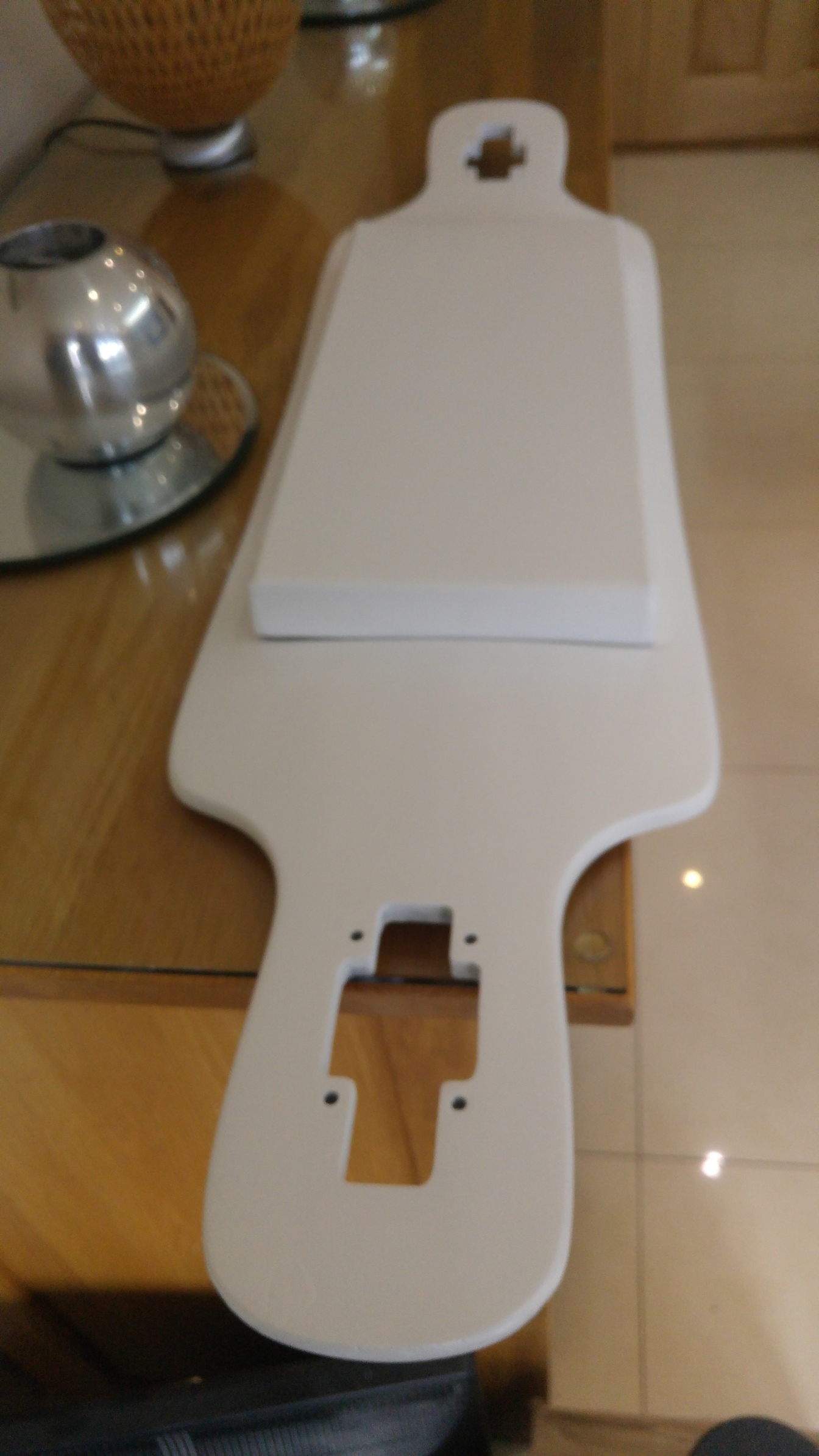

Build No2 mix of new and old parts Mindless LONGBOARD enclosure made from scrap in work (thanks boss and gary) Hobbyking sk3 192kv from build1 Turnigy nano-tech A-SPEC 6600mah 2S 65~130C Lipo Boat Pack x5 Bms Bestech 10s hcx-d223v1 100mm all-terrain longboard wheels black i wanted green 15t/40t pulleys from TITOXD1001 Motor mount from korrh (very nice) Black cal 50 clones Quanum 2.4Ghz 3ch Pistol Grip Tx & Rx System what i dont have esc/vesc

Out with the wet and dry again
Lighter fluid dissolves glue in seconds.
On my clear polyurethane finished deck, I used 0000 steel wool to smooth it out and it worked great. Made the finish really smooth but still left it shinny. Not sure how it would work on paint though.
Ill try steel wool used it befor might work,
I had no steel wool so i used wet and dry sand paper wet looks a lot better its going to get 3 coats of anti chip gloss spray and 120 shamrocks
