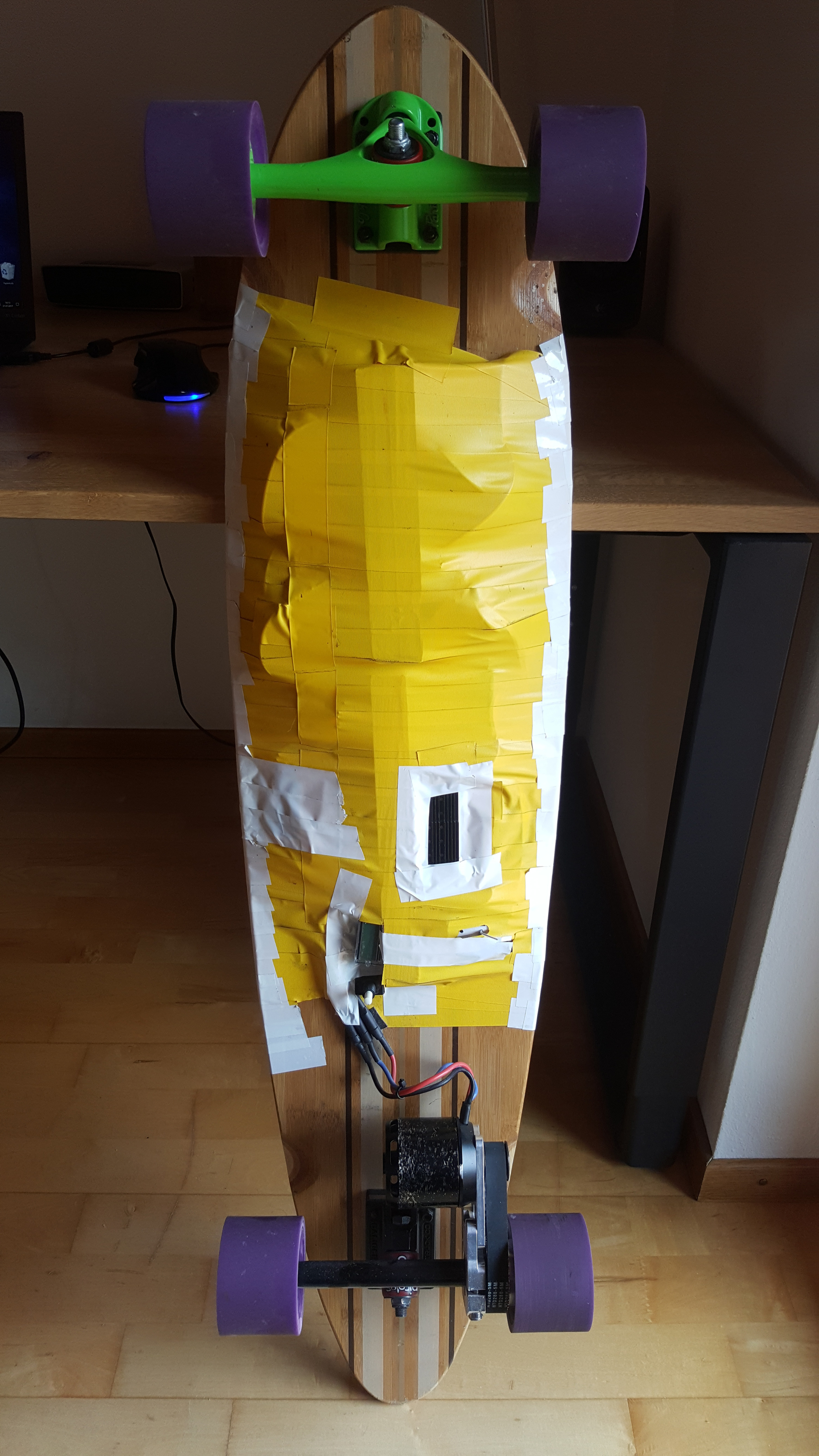

First of all: Don’t judge me because of all the ugly tape. I have not had time to finish my enclosure. Half of it has been sitting in my workshop for weeks now .
So I have been riding this bad boy for about a month now and I love almost everything about it. I have build this board similar to Namasaki’s build.
Here are what parts I used:
- 5 LiPo 2S 5000mah 40C batteries from Turnigy
- 10S BMS from Bestech
- Maytech VESC from APS ( have not had the best experience with it. Read more about that here )
- APS 200kv 6374 Motor (great motor btw.)
- a little battery indicator from APS as well
- motor mount from APS ( great mount, just don’t use it with Paris Trucks. read more about that here)
