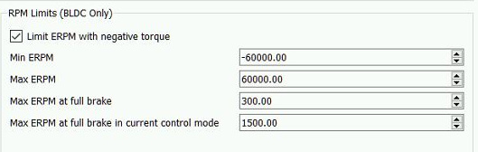

Mine is allready at 60k MAX ERPM, I thought that was the most it should be because of DRV issue?

I think it is possible but I am not sure. the setting is on the first page and you already have it set at 60k. Chaka is an expert on the vesc and could probably give a better answer.

I am trying to figure out if its possible to run the 260kv motors on 10s by adjusting the ERPM limit. IF so, whats the math to define what the ERPM limit should be? If that is possible.
Sorry if Im not being clear, it may not be the ERPM limit that is critical but that’s the limit that I am trying to avoid passing so as to not burn up the DRV on the VESC.
the erpm limit should be 60k because thats what the vesc can handle. theres no way to adjust the erpm of the motor except by lowering or raising the voltage supply. the KV of the motor is set and can’t be changed unless you re-wind the motor. What I was suggesting is that setting the erpm limit in the vesc via the bldc tool to 60k which you have already done might be enough to keep the 260kv motor with 10s voltage from overloading the DRV chip. But I am not sure about this. I haven’t tried it so it’s only speculation on my part. I would ask someone like Chaka about this before trying it.
