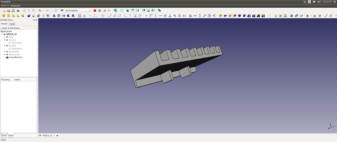

This is something I have been intending to create once our mill is up an running. It will be interesting to see if it increases the capability of the VESC with a more direct connection to the base of the fets.

Its coming back to me now why I abandoned the custom heat sink. I didn’t want such a large positive terminal exposed in my system.
Is there a non conductive material that could still be used to dissipate heat or at least as a transitional material to the heat sink?
i think heat and electricity conductibility go pretty hand in hand except for some fancy pastes and silicones.

If the Vesc Enclosure itself was the Heatsink, then it would be directly exposed to the wind for superior cooling, …seperate from the battery enclosure.

Can’t we build a Heat Sink “Evolve style” , which is exposed to the wind ??
Just having Wind cooling the Fins,… seems to me would make a big difference?
Chaka didn’t mean to step on your heatsink progress with the over-the-top title. I thought it might lure more people. When u say u don’t want to heatsink the bottom of the fets because of the large positive terminal are u afraid people would short the board? I’m looking to get the most cooling possible as I’ll be running one hub motor and anticipate a lot of amps and heat
Yea having one giant exposed positive terminal is never a good idea. Super easy to short. When I rode with you last time it didn’t seem that your VESC got that hot. Given, you were on a dual setup, but I don’t imagine it’ll get that much hotter on a single especially running 12s. I have some raspberry pi heatsinks you can throw on the mosfets if you want. Since you don’t run an enclosure the wind hitting the sinks directly should help control temperatures pretty well.
On the original post, @Hummie mentioned the IRFP7530 MOSFET which happens to be the exact MOSFET im using in my EBoard Switch and doing the math the 7530 wouldn’t need a heatsink at 30A continuous in a 63°C environment at its max RDSON which is usually around 1.65Miliohms not 2 which is what I based the calculations off of. Anyways the 7530 would be a great substitute for the VESC fets if it ever becomes necessary to increase the max VESC amperage. Also people where worried about heatsinks possibly shorting out things because they would be live connections, but you could just use non conductive thermal past to fix that problem, thats what most people do for adding heatsinks to fets because the flange is usually a drain as well. IRFP7530PbF Datasheet
