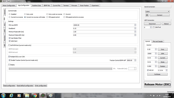

this should not be causing you any issues, but I’m pretty sure you only need PPM, no need for UART with the winning remote. Can you show app configuration/ppm too? I doubt anything on there could be causing issues
Yes I think this is one of, if not the main culprit to my troubles. It came seemingly set far too high. It was set on 40 instead of 0.04 - that’s vastly different…
I had to set my minimum pulsewidth to 1.10 and max to 2.18, that could just be me, but it’s only difference i can tell. maybe try check read configuration in case only do this to the master vesc-the one with the remote going into it Go to app configuration/PPM read configuration show display put remote onto full power read what number it tells you (mine says 2.18 at full power) enter whatever it tells you into max pulsewidth write configuration Your video i saw one some other thread made me think that your max pulsewidth is low
