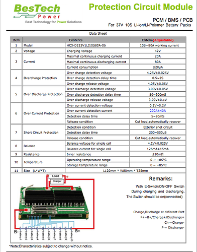

I wouldn’t be surprised if we got the Bms’s in a week or week and a half. Bestech is fairly quick on delivery. And this is my 3rd order with the same sales rep. and she has been very good to work with. I sent her a couple emails this evening and she answered them within minutes. I’ll let you know as soon as they arrive. As for the batteries, did you check them with a volt meter? HK doesn’t usually send batteries with full charge. 3.7-3.8v per cell is good for storage voltage. It is a good idea to have a hobby charger though. You want all the cells to be the same within 1 or 2 tenths of a volt when you connect them to the bms. Because if any of the cells is way off then the bms will not be able to balance them. I experience this once when one of my packs got a loose power wire and I had to replace it with a new pack. the new pack was at storage voltage while the rest where around 4.0v and the bms would not fully charge. I had to hook my hobby charger up the the new pack and charge it up by itself.
Here is the final spec sheet for the Bms’s Lucy said the operating temp was wrong on the other sheet and she made the correction. so it will be 0-85c

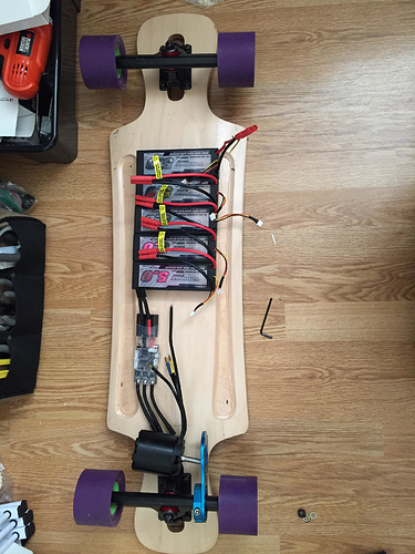

I am trying to figure out the best layout right now since my board is on the shorter side. I think the bms should fit length wise right beside the vesc since its about 3x5 inches. It will be a little tight with the other boards like the remote receiver but it should all fit!
Next thing to figure out is the wiring. Looks I’m going to have to get a bunch of connectors. Not sure what kind is best. The vesc has 5.5 bullet connectors going to the motor and a XT60 connector. So I think I will just need a female XT60 and a few more bullet connectors also something to split the wire where it goes to the bms.

Also noticed that in the picture above you don’t have the charge port connected. Did you just splice it in where the wires branch off to the VESCs ?
The pos wire from the charge port splices into the pos wire from the battery. The neg wire from the charge port goes to the C- solder pad on the BMS. Take your time especially when connecting the balance wires. If you get the cell order wrong, it might fry the circuit. Double and triple check.
It might be too late, but don’t need to solder your battery cables to put them in series. Just modify the HXT connector by carefully cutting the thin plastic between the two leads. The HXT then becomes a male/female 4mm bullet connector with protective housing. You can directly connect the positive of battery 1 into the negative of battery 2, and so on. Very little bulk
I tried that option and it was more bulky and didn’t leave a clear space for the balance wires. When using a low profile enclosure every mm counts. Besides, less connectors=less resistance.
