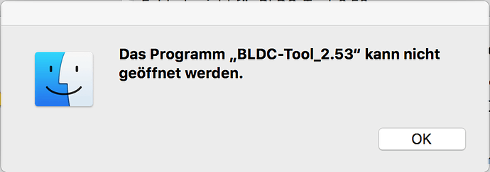

Hi,
as demanded here are some screenshots of the installation process as well as of the failure:
And here the detailed report:

I think it could be that the OS isn’t supported yet, because that’s the normal problem I encounter with software even I have no beta OS running on my Mac.
Maybe the Log will help you @The_Dude.
Greetings -Daniel
OK - which OS X is installed on your system?
MacOS Sierra
OK, I’m still with El Capitan (10.11). Don’t now when I will upgrade, but after that I will rebuild the app and send a notification.
I guess the reason is that the librarys like QtPrintSupport are missing. These libraries exist on your machine but not on others. So they need to be added in the pkg. I had to do the same for windows.
Updated my former post. Seems I was right with the OS
Hmm … not that trivial for me, the aforementioned path does not exist on my Mac.
I tried with OS X Yosemite (10.10.5), it doesn’t work neither.
Must be some missing libraries, I will try to elaborate on that - Ackmaniac offered his support. I suppose, you have not installed Qt?
