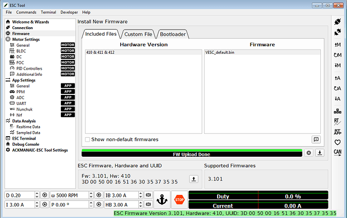

Is this just a ESC-Tool update to Version 3.102? Or Firmware? I’m still getting 3.101 in version 3.102 when flashing the firmware.
Tried it out. But it immediately closes when trying to connect. Thanks for compiling this though dude.
Saw that also by now, seems that i mixed something up with the exe file. Will fix that soon.
Thanks dude!
Strangely having problems compiling the version with the icon for the tool. So i just added the version without the icon for the moment. Firmware doesn’t care about the icon so you can use this one without issues. Will try to fix the icon version tomorrow.

Did you already upload it? Looks like the same version as before.
