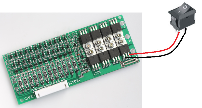

the 2 spots in the circle should be designated for e-switch/temperature switch. If you could provide me with hi-res pictures I could confirm what I am saying.

So If I short that the BMS will power down?
So Lilian told me you connect the switch like this,
However, she said the BMS would have to be modified first before you can do this.
Here’s some of the email thread
I will try to explain: When it comes to print a circut, although the bms company has several models of the same bms (the standard, the fancy one with an e-switch…), they manufacture just 1 type of printed board; all the fancy add ons will be added later.
These 2 spots (see pic) could have served 2 functions: 1)temperature switch 2) e switch ACCORDING TO THE ONE (function) THEY PICKED, YOU HAVE TO OPERATE IN 2 DIFFERENT WAYS TO ADD YOUR E SWITCH
1)spots designated for temperature switch: IN THE NORMAL CONDITION, current DOES flow through the temperature switch. TO GET THE BMS IN “ALARM MODE” (to turn off the battery) you will need to OPEN THE CIRCUIT: remove the resistance next to the spots (see pic).
2)If the spots are meant to be for an e-switch, it couldn’t be easier: just short them to turn off the battery.

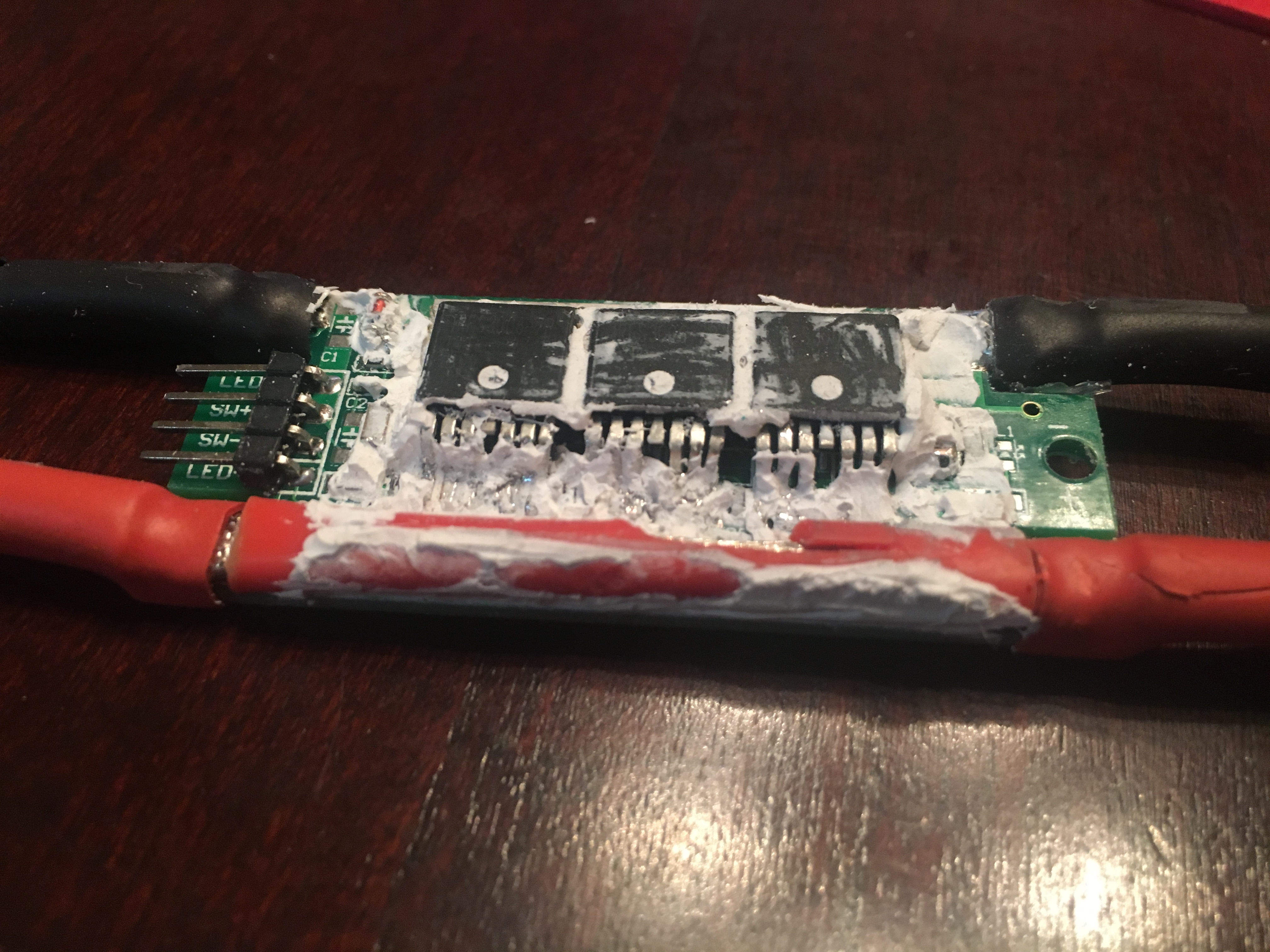

Im working on trying to replace my Mosfets on my electric switch and digging this out has me like,… um… no!
