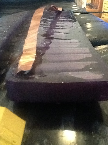

Here’s a million drop deck pics. I really like to get dropped and then some. What’s the green battery compartment made of? I ask because I’ve been doing a similar thing with either just velcromand more recently just polyurethane. Sticks great but have destroyed many cells. Was told they were fragile but didn’t believe
