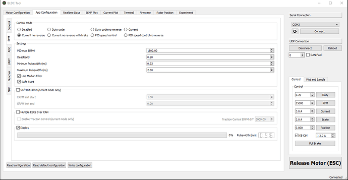

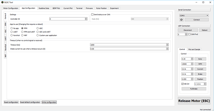

Interesting… Post some full screenshots of your PPM and App Config Tab please.
Also, can you post a video of you pulling the remote? With no load it may seem that it uses very little throttle range but when you ride it should be fine.
Download @Ackmaniac’s modded VESC tool. It has an auto wizard for calculating the correct PPM values and a bunch of other stuff. (When not touching the throttle you want the green bar in the middle)

The full throttle is because you’re using current control. For boat use duty cycle or pid speed control and set max pid erpm to 60k
Thanks, but on those settings the motor starts, then just keep running and there is still now throttle control to vary the speed? not sure why this is being so difficult on me… lol
are you using “Duty Cycle no reverse”? If you do it’s assuming you’re starting from minimum PPM (as if you’re throttle was all the way down) meaning neutral on a normal controller will act as 50% speed. You might want to use PID speed control instead.
I tried both. they just start up, then go full out and nothing I do turns the motor off, so I just select a different type of control mode and configure to shut that down.

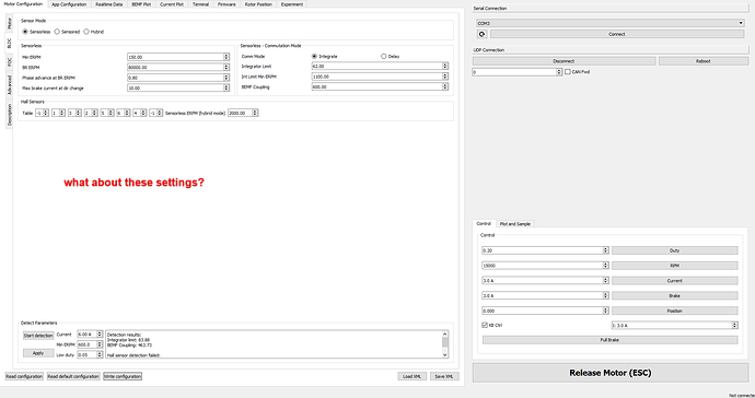

Looks like you didn’t apply your motor detection settings. Make sure to hit “apply” and “write config” after detection.
ok made some changes and it varial speed now… cool! Thanks we almost have it!
