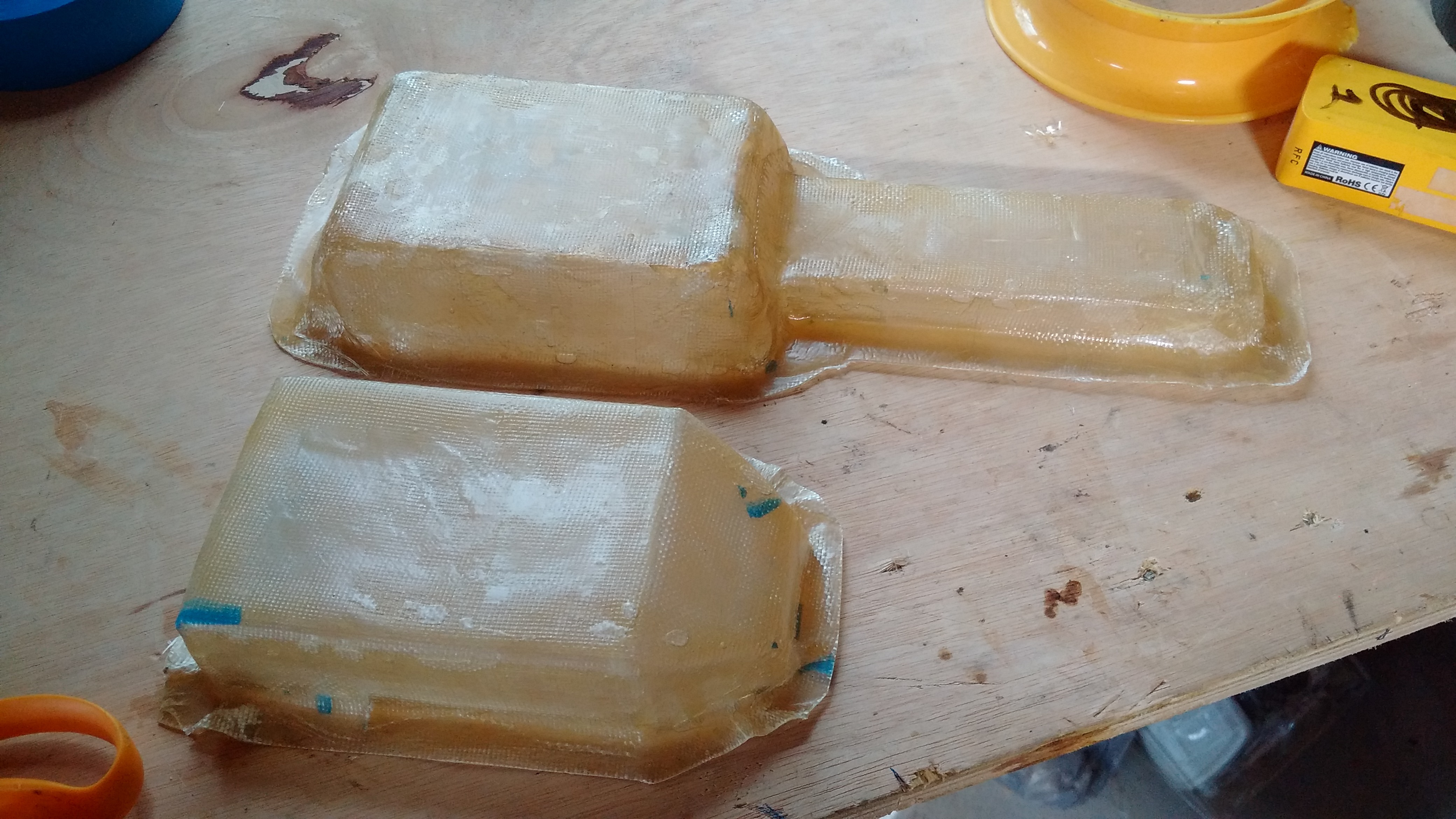

so the next big step is the enclosure… On my last build, I used wood to match the deck. This time, I wanted to try something new, so I decided to use fiberglass. I made one earlier attempt, and it went quite well. This is my second version, and I think it is looking pretty good so far. It still needs some fine tuning, but the general shape is what I was going for.
Still in progress, so I’d love to hear anyone’s suggestions!
Also, I realize the two small batteries will give me a really short range, but this build is mostly parts I had on hand, so I didn’t want to order anymore lipos.

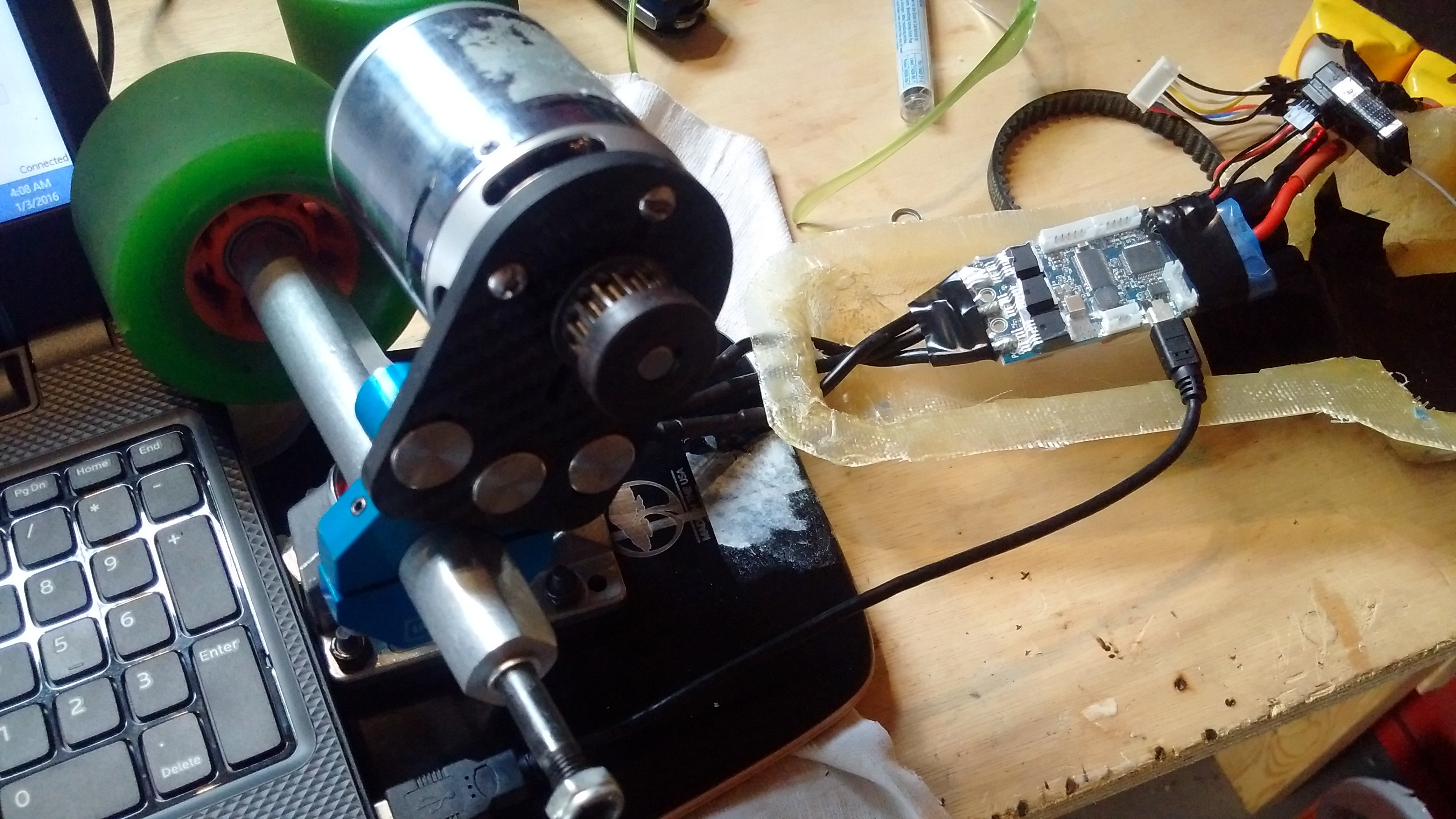

Soldered up the bullet connectors to connect the motor. Ran through the BLDC tool with almost no troubles (had to mess around with the com ports a little)
So right now here’s where I’m at:

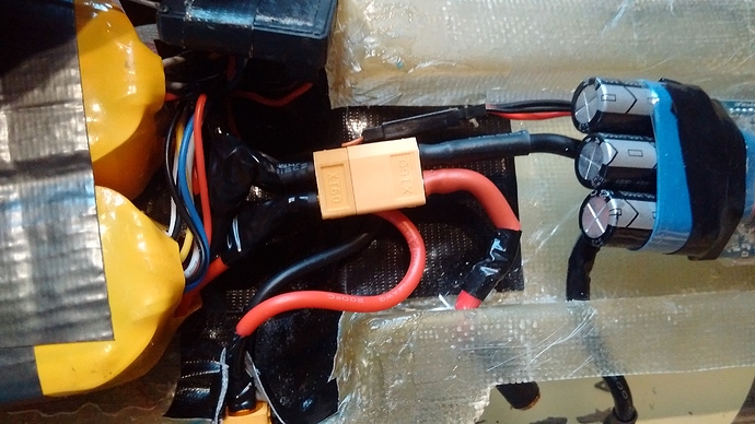

my on/off switch is just that bullet connector hanging out the side… I’ve ordered some anti-spark xt90’s to make a loop key, but this is what I got for now.
charging xt90 is on the far side, and the balancing port the close side: I have ordered some 9pin plugs that will have both the balancing and charging wires hooked up to them so that it is one simple plug for charging.
I also got some spray paint that is apparently supposed to be like truck bed liner, so we will see how that goes…
before the paint, I will clean up the edges of the fiberglass box, and do some light sanding. I just need to get a better mask before I go that far.

Nice! simple and clean!
I’m curious about charging in parallel though. Isn’t there a possibility of over charge or over discharge issues due to different cell resistances of the two batteries?
yes, because you are technically balancing a parallel of two cells.
I bought both of the batteries at the same time, and both have had the same amount of cycles- I think with the cutoff set at 3.3volts per cell, and by charging to 4.15volts per cell the lipos will be just fine.
There are a lot of people who charge their lipos in parallel with no problems, so I will see how this goes!

(that little black square sticking out is th balancing port taped up… I made the mistake of permanently attaching the charging port before painting… so the batteries were left inside the case)
