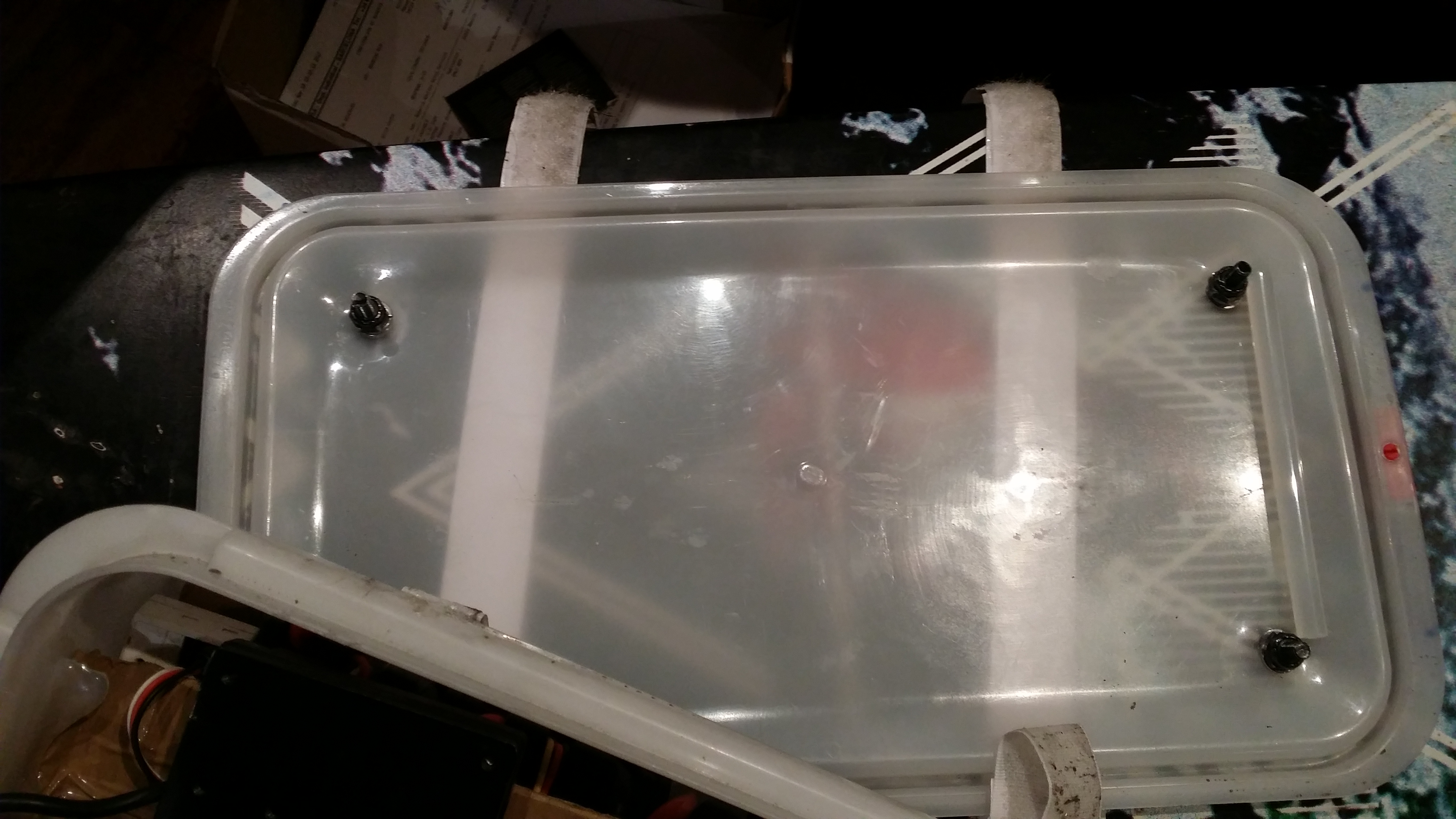

Next… The enclosure… Good enclosures are hard to make and expensive to buy, but the upside is that you can easily overcome the problem with almost any box and some tape… Of course, it will look like shit… But you’ll be able to ride.

Monday I will install a voltage meter… And just hope to be able to work the kydex I have at home without losing my shit… Into a proper enclousure.
I have few pictures, which I will post below, and will keep this a log for coming updates and the such.
